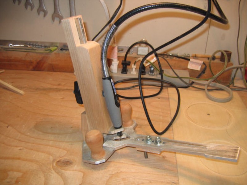

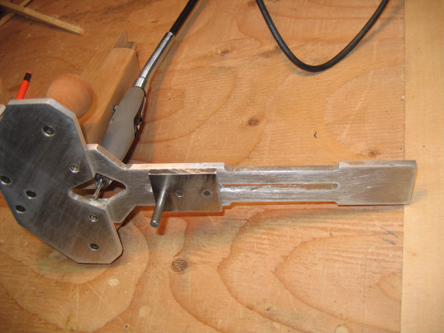

Greg I just made a base for a dremel and use Stew Mac down cut spirals, I have gotten fantastic results. I can adjust the diametre of cut using my digital calipers and referencing off the plates on the bottom of the base, I can get with a couple of thou! Here is a picture, aluminum, maple and mahogany, all of which you can cut with you woodworking tools, at least I did. I have since added some mac-tac to the bottom of the bases to keep the oxidizing aluminum off of the wood surfaces.
I think I posted an earlier thread on this little device but I can help you out if you want to make one.

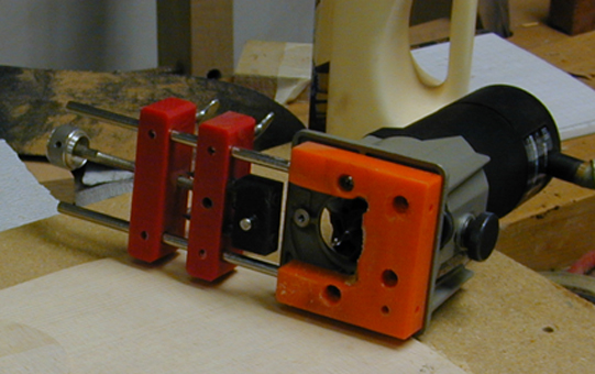

Here is my home made machine - UHMW plastic, and 1/4 rod threaded 1/4-20 - makes for easypickins on knobs and such. The red parts both lock on the rods, the leftmost is set first, then you can turn the old Gretsch knob to fine tune as it then only moves the centre red section. I had to add the black section for the pivot pin in order to get under the trimmer base for 3.5 inch soundholes.

Tony that looks really nice. So does the threaded rod just push up against the block on the right or is it attached so it can move in either direction. I'd like to see a picture and explanation of that.

yeah sorry Bob .. the picture isnt htat clear , but it was the only one I had already in the PC, without going and taking another one !!!
So maybe this helps.
The first red block is 1/4-20 threaded right thru, as is the centre rod (the outer two rods only thread into the router base to be solid). The centre red block has a 1/4 inch hole thru, but the rod is threaded. On both sides of the centre block are nylon lock nuts, snug against the block, so its tight on the rod, but the rod still turns. So ...
When the outer red blcok is locked on the rods, and the adjustment knob is turned, the centre block with the pin extension on it moves in or out as required.
I basically copied the Schneider rig out of the old LMI catalog, but instead of a knife blade, its a router bass. A couple local guys also copied it, and I made one for a students Xmas gift per his girlfriends request for luthing tools (OOh baby I luv you smooch smooch) !!!!

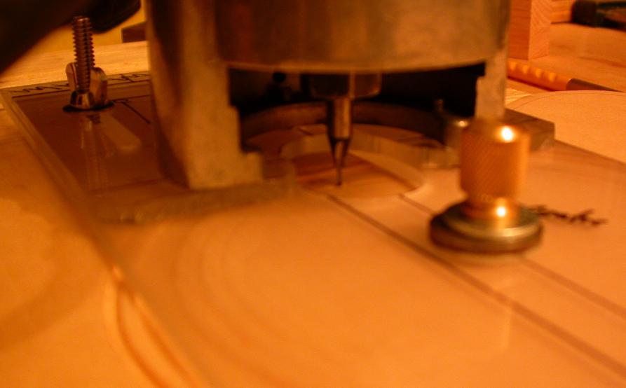

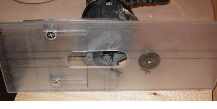

   Ugly as sin, I'll readily admit, but it works like a dream. I just set it up under the freatboard and I have no worries. I just have to make sure the sides are square and voila!
   I had the plexiglass lying around the shop, all I had to get was the centering jig (9$ at Lee Valley) and two bolts with the washers and wingnuts. Ten dollars and about an hour latter, I had me a circle cutting jig.
   I just made sure to sand the bottom up to 2000 grit... I wonder if I should try to patent this desing... ;) Cheers.

PostPosted: Wed Jan 04, 2006 1:58 am
So when using this type of jig, how do you micro adjust if the shell and surrounding rings just arent fitting into the trough ???, a little tap on the back and go for it ??? Thats one thing I like about my design - its almost foolproof to add 3 or 4 thou.
PostPosted: Wed Jan 04, 2006 3:50 am
[QUOTE=TonyKarol] So when using this type of jig, how do you micro adjust if the shell and surrounding rings just arent fitting into the trough ???, a little tap on the back and go for it ???
    Exactly. I don't actually tap mine, I just 'press' the bit against the channel under the fingerboard. Simple tooling for simple folk!
